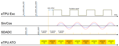

I have configuated the squre wave output to the resolver by the the exc channel of the etpu.But the circuit board what i used now is based on the spwm wave of the exc output other than the square wave.Thus i has to change the wave output type in the software.
So what i need is the spwm wave output generated on the 300khz carrier wave.and the spwm frequency is 10khz.The core used is MPC5777C,and the module is the etpu module.How to configuate the SPWM wave output in the resolver part of the etpu module?If it is infeasiable,is there other ways to make it come true?

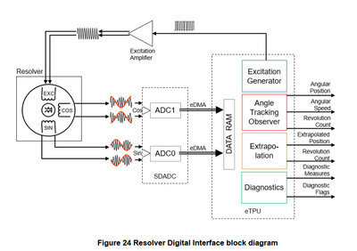

The generation of the exciting square wave signal of the resolver is linked with the soft resolver algorithm, and is not independent. The existing eTPU motor library can only generate square wave signals, and cannot generate the exciting signal through SPWM.

Are you using the NXP RESOLVER eTPU function (new motor control set)? That function does control the excitation output and as you note, generates a square wave (typically close to 10khz).  If your hardware for some reason requires something different, and yet you want to use the NXP RESOLVER eTPU function, you would likely need to modify the default eTPU software to meet your needs.  But it is not clear to me what your system hardware is, or whether you are using the NXP eTPU resolver software solution.

I cannot say based on the limited information provided whether what you want to do is feasible or not. But to the explore the possibility you would need to modify the baseline eTPU resolver code. So you need (1) the source code, and (2) some eTPU development tools (you could get a free evaluation copy from ASH WARE). You would then need to look into modifying the excitation wave generating code, making sure that it still supported the existing synchronization and phase shifting capabilities (the existing code phase shifts excitation output based upon feedback from the SDADC data to ensure the sample period aligns with the sine wave period). An interesting project, but again, I can't really comment on feasibility without knowing quite a bit more.

It is expected to have excitation amplifier on the eTPU PWM output to create sine wave for the resolver.
