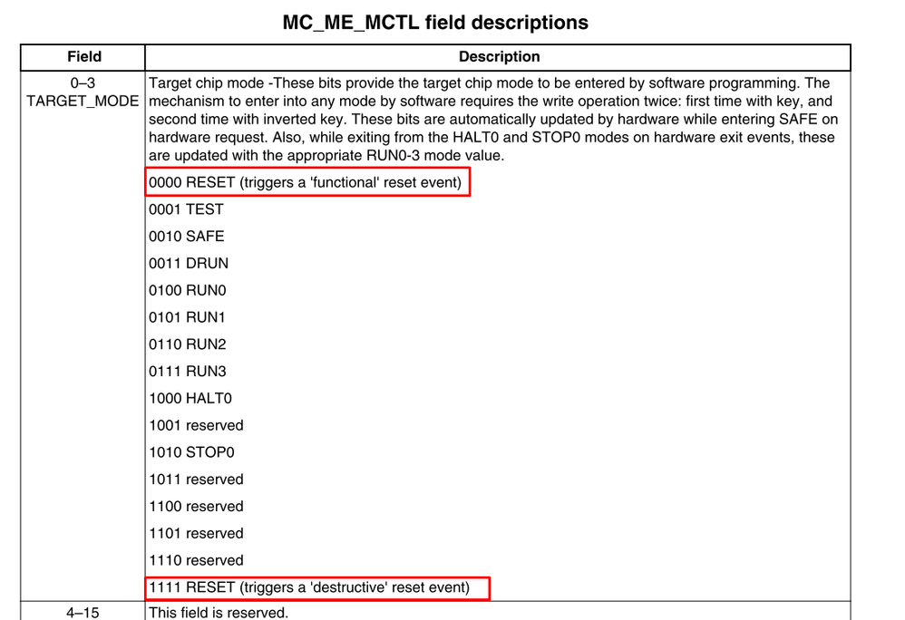

Dear Freescale,
I want to generate a reset via software to enter the bootloader, how to?
Do you have sample code?
Thank you.
865 Views
petervlna
This is quite simple:
Use mode transition to reset state. Functional or destructive.
    //Mode transition
    MC_ME.MCTL.R = 0x00005AF0;              //Functional reset Mode & Key
    MC_ME.MCTL.R = 0x0000A50F;              //Functional reset Mode & Key
or
    //Mode transition
    MC_ME.MCTL.R = 0xF0005AF0;              //Destructive reset Mode & Key
    MC_ME.MCTL.R = 0xF000A50F;              //Destructive reset Mode & Key
