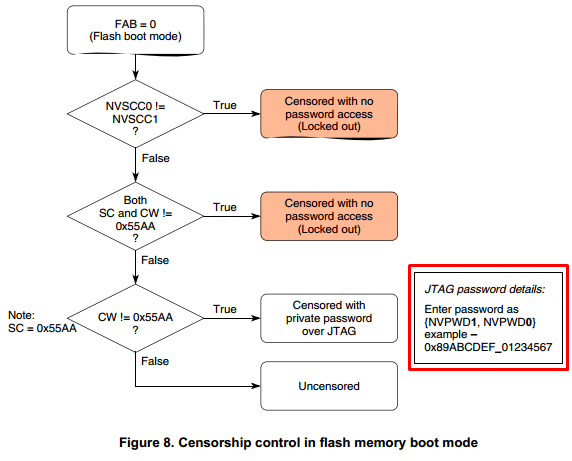

How can I access the device via JTAG? I have the censorship password. In Reference Manual there's only on note:
JTAG password details:
Enter password as
{NVPWD1, NVPWD0}
example –
0x89ABCDEF_01234567
But how and where should I enter it (register?) ?

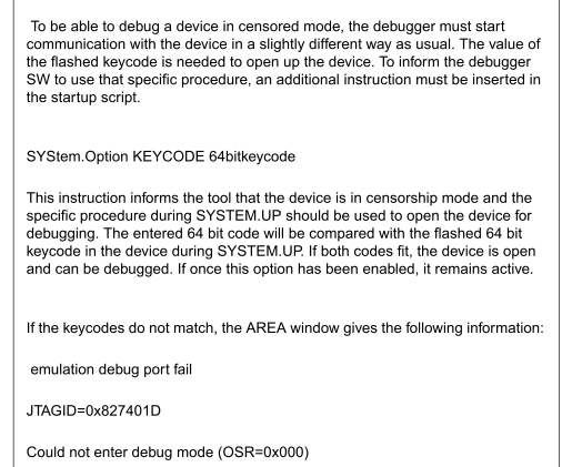

try the following process described in official Lauterbach documentation:

This is definiteIy not a solution. This process only describes Lauterbach specific configuration. Neither does It say what the Lauterbach debugger does, nor do I have one to test it. I am using my own developed debugger and I have to add the feature to access censored devices. So what I need is the description of JTAG censorship unlocking sequence. It is mentioned but not explained in the reference manual:
