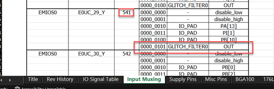

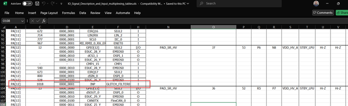

davidtosenovjan

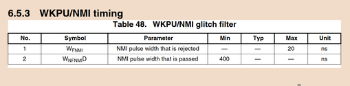

IGF is being selected according attached I/O excel:

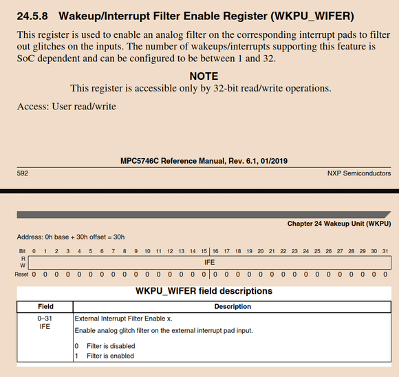

However this is not anyhow related to WKPU module. It has its own glithc filter being enabled by
having following filtering behavior
4 返答(返信)

Can you pls confirm that the implementation suggested above by enabling the register WKPU_WIFER on corresponding interrupt will meet the intention of requirement from safety manual i.e. Chapter 5.2.27 Glitch filter?
タグ(1)
640件の閲覧回数
davidtosenovjan
Chapter '5.2.27 Glitch filter' only mentions the presence of glitch filters there, it does not say anything else and they can be used.
