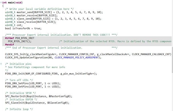

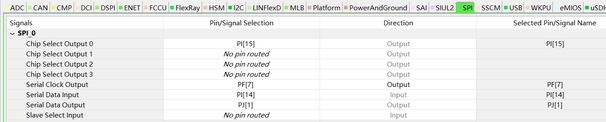

1.Question description

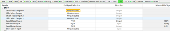

How to configure the Chip Select output in SPI communication of MPC5748G from the default optional pin to another Chip Select output pin of DSPI?
the default pin of Chip Select output  in SPI_0 communication of MPC5748G is PI15. there is need to change the pin PI15 into PD15 of DSPI_1.
2.Source program
3.The changed program
The changed program doesn't make the SPI communication. Don't know what the problem is. Hope someone can help me. Thanks.

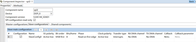

PetrS

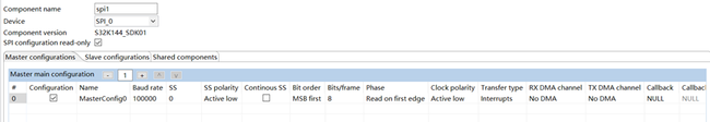

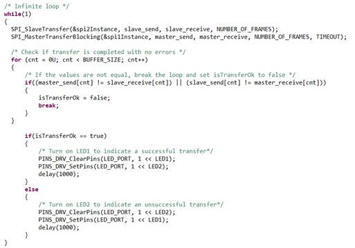

this is bus signals from original demo.
You can see chip select is deasserted. Seems spi_pal driver does not allow continuous selection.
After your modification, you did it in fact, but probably it is not allowed. Bus signals is
So you need to deassert CS between each byte, you can do it as
then signals looks
and communication is correct.
You can also test dspi driver which has an option for continuous selection.
BR, Petr

PetrS

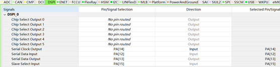

so does it mean you do not see PTD15 pin toggled by SW?
You should not set PTD15 in DSPI tab of pin_mux component, but rather in SIUL tab.
So remove it from DSPI1 and add below
generate PE code and build.
BR, Petr

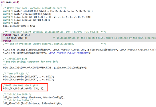

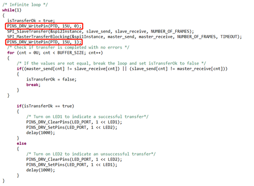

The official demo program uses SPI_0 and DSPI_0 configurations in SPI communication. Where, the default pin of Chip Select output in SPI_0 is PI15.
We now need to use a different pin as the CS output pin. Here, we chose the PD15 pin in GPIO.
Generate PE code and build.
2.Source program
The source program for SPI communication is shown below.
First pull the PD15 pin high.
Then, pull the PD15 pin low before communication, and pull the PD15 pin high after communication.
But, the changed program doesn't make the SPI communication. Don't know what the problem is. Thank you for your help. Thanks.
