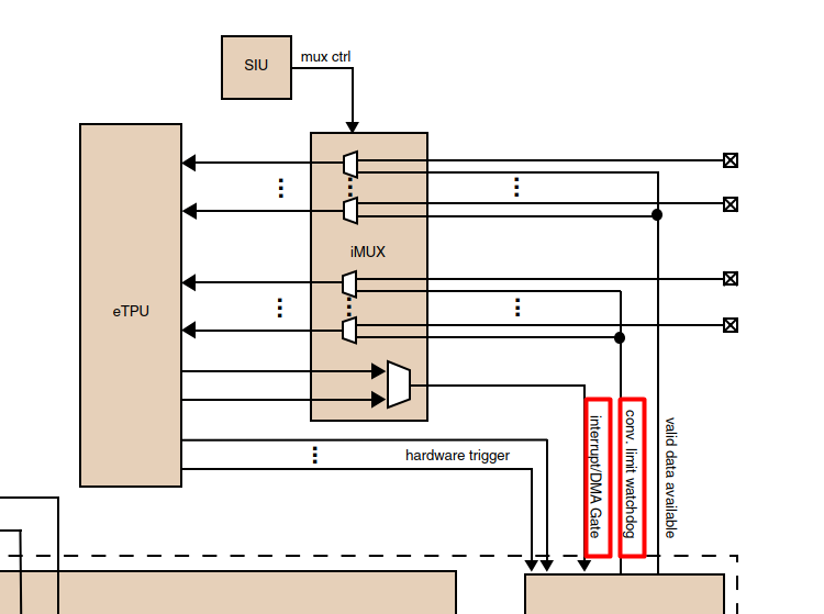

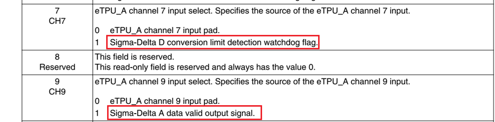

HI, I have just test it and I think this routing between SDADC and eTPU actually is not implemented.
Only following SDADC related registers are present in the SIU chapter and none of them are connecting 'valid data available' signal. I am checking it with the factory, either the register is missing in the document or the feature is not implemented and it needs to be removed from the documentation.
I will keep you informed.

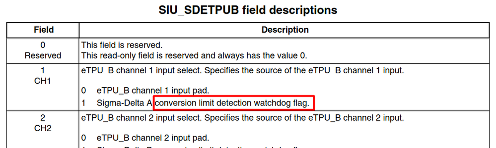

Did you check for "Conversion limit detection watchdog" signal? Is it ok?..I have configured this signal to be input of ETPU channel, but the ETPU channel state always be 0, the behavior is the same the "Data valid" signal case.
Regards.
1,651 Views
davidtosenovjan
You are right, this does not work to me as well. I will try to check it with the factory, if there is anything else needed to configure. Currently I don't know the reason. I will return to you as soon as possible.
