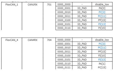

In my case, I use MPC5746B. That has 6 FlexCAN interfaces. So I think I can bind two CAN interfaces for handling over 64 messages.
My plan is to use only one external CAN transceiver. And the Rx pins of two FlexCAN are connected together with CAN transceiver's Rx pin.
I will use FlexCAN1 and FlexCAN4. It have common pin for Rx like PC[3], PC[11], PF[15] and PJ[13].
Is it possible to config FlexCAN_1 and FlexCAN_4 use PC[3] together?
Is there any worries about this?

No, it's impossible. PC[3] is configured on Dio/Port driver. A pin should only configure on a single mode. There will be no way to configure the pin for both FlexCAN_1 and FlexCAN_4

Smin
Thank you, @CongDang
You mean that ...
SIUL MSCR#35 selects the pin function among FlexCAN1 and FlexCAN4. MSCR can not select both pins simultaneously.
Q1. Then, to use both FlexCAN1 and FlexCAN4, I should config two pins for each FlexCAN. right?
Q2. Is there any limitation to using several FlexCAN Rx pins on ONE CAN transceiver?
I just want to add more FlexCAN Rx ports on the previous Rx port as below.
Q3. Is it possible to use only RX port of FlexCAN? or have to use Rx and Tx together?

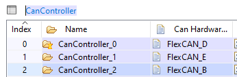

Anyway,  let me share my config and the test result.
I added 2 port more for FlexCANs and assigned 2 CanController. The new CanControllers are set as LOM.
At the CanHardwareObject in MCAL,  I assigned a different controller to each message buffer.
I tuned my generated AUTOSAR code to handle new FlexCAN without CanSM and ComNM and it works.
By selecting a different Can Controller Reference on each MB, each FlexCAN module receives separate unique CANIDs.
e.g. CAN1 receives 0x100, and CAN2 receives 0x200. And it works well.
I just triggered this thread to check my configuration is the correct way for this concept.

CongDang
With the EBtresos configuration that you show, are you using the below setup (I'm not able to insert pictures in comment so I'll describe
- both TX, RX of CanController_1 is connected to CAN Transceiver
- RX of CanController_2 is connected to CAN Transceiver (same with RX of CanController_1), TX of CanController_2 is not connected
- Config HOH for receiving on CanController_1 with id=0x100
- Config HOH for receiving on CanController_2 with id=0x200
And the both HOH work well?
I find it a bit strange because as far as I know If CanCotroller is in LOM, it can only receive messages that are also received by another CanCotroller that is not in LOM.
