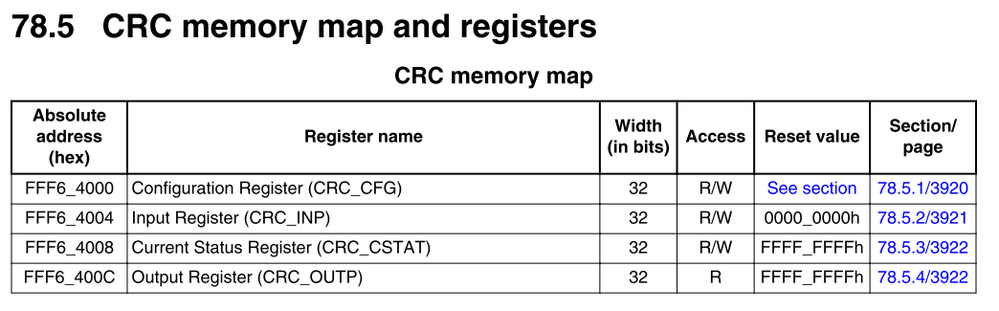

I would like to know how to clear the CRC unit OUTP when I want to start a new CRC check sequence and abandon all the history values. This seems not an option based on the reference manual. Is it possible?
Or does the history value get auto cleared after the OUTP reading?

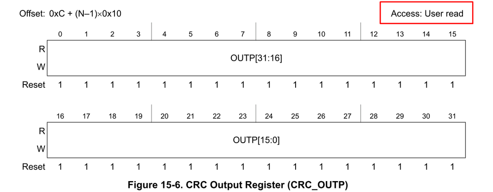

petervlna
This register is read only. Writes has no effect.
After reset it contains value 0xFFFF_FFFF
I expect that register is not cleared on read. I will verify it tomorrow in office and let you know.
