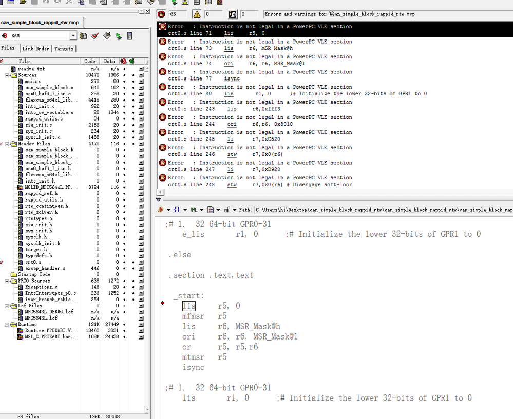

     I want to  build a MPC5643L CodeWarrior project using codes  generated by toolbox,   but there're some errors I never met .Can anybody give me some suggestions to configured the CodeWarrior project?

It would be really faster for you if you could specify the compiler errors here.

     The attachment is the simulink model and the codes generated by the model.

You are using BOOKE instructions in section which is targeted to be VLE.
Reword it to VLE or dissable VLE and leave them as BOOKE.
