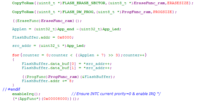

 I want to design mpc5604b bootloader , i've developed an demo project in CW 2.10, but some probelms occurs ! The demo project copy a led funciton that residents in flash space from 0x000210c6 to 0x000210ea  to the other flash space from 0x00008000 to 0x00008024  , and then jump to 0x8000 to run the led demo function !but it didn't !

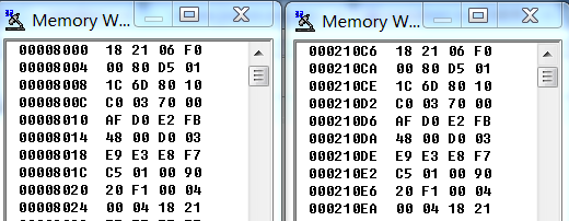

I debuged the demo project ! Based the below figure, I programmed the led function into the other flash space according to flash driver successfully !
I use the following jump syntax , i wonder that it jumped to wrong address , or that  the syntax is wrong !
the demo project codes :
This problem has bothered me for a long time.! Please help me !

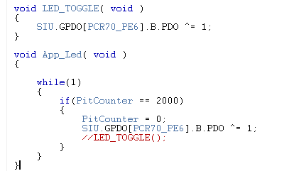

In the function App_led , I called a function LED_TOGGLE , and I modified the App_led function as below ! The led function will run the dead loop forever ! It's strange ! why ! I want to find the original reason of the problem ! Help me ! Give me your suggestions !
Hunter
