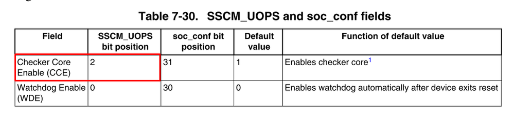

How do I enabled or disabled the Checker Core_0 used in lock step in MPC5744P ?

petervlna
you can configure it via SOC configuration DCF record.
Peter

wuyuanhang
Thank you very much!
