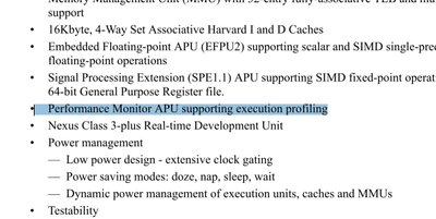

I am using s32ds power architecture 2.1 and I am currently trying to calculate encryption/decryption time for cse project.
I tried using time.h but I don't think it works in s32ds.
Is there any way I can do?

You can use for example external tool like Trace device to see the execution of instructions.
Or you use performance monitor located on core:
Please refer to the Chapter 8 Performance Monitor of core reference manual.
Peter

Is the manual for MPC5777C? because I don't think I have the same reference manual as yours. Mine says System Integration Unit for chapter 8

I was referring to core reference manual, not uC reference manual.
https://www.nxp.com/files-static/32bit/doc/ref_manual/e200z759CRM.pdf
Peter
