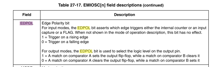

Hi. I just started to learn MCU. This question is maybe too simple.
I tried to change the mode of an eMIOS pin.
this is a picture of the window in 'CodeWarrior'. And, I'd like to change the Edge Polarity from Set On Match A to Clear On Match A.
But, I couldn't find the way.
Please let me know how. Thanks.
