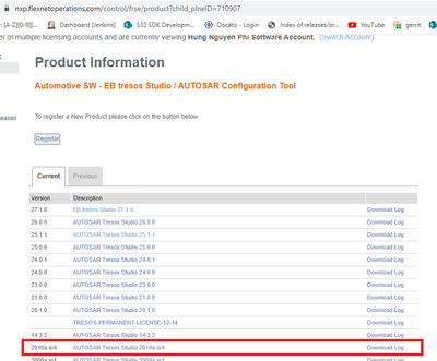

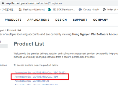

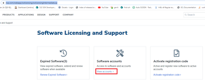

hungnguyenphi
Hello @Ehsaaan ,
Please access the link https://www.nxp.com/webapp/swlicensing/swlicensingIntermediate.sp
Hung
