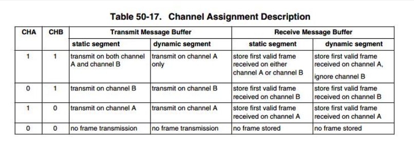

Whether the FlexRay node can receive the packet with id 1 in channel A and send the packet with ID 1 in channel B

It should apparently work. Every MB can transmit over channel A or B or both.
