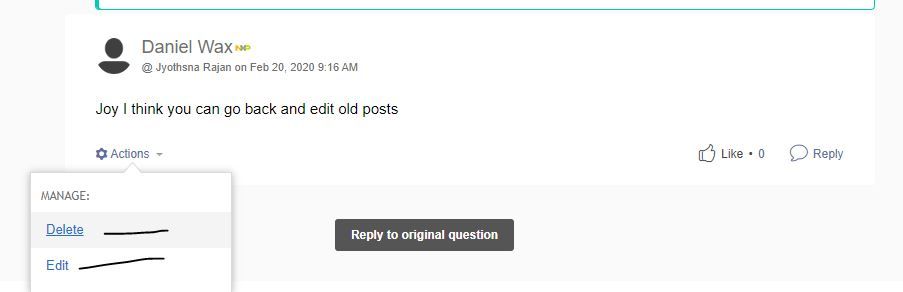

Daniel_Wax
Joy  Cant you can go back and edit old post and remove stuff if needed?
