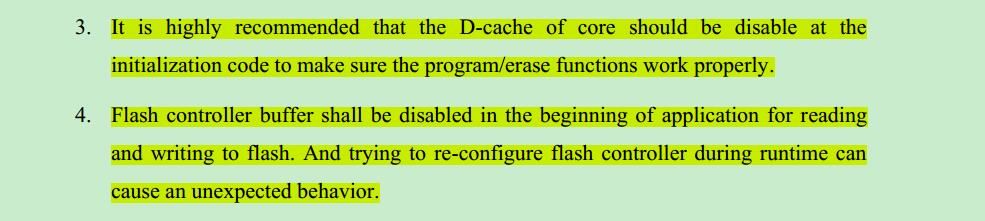

Hello , I have check the User's Manual of the SSD.
About the 3.3 Notes and Limitations.
On the 3, how to disable the D-cache ? I have check the SSD demo just disable the flash controller buffer, but not disable the D-cache.
Could you give me some advice?

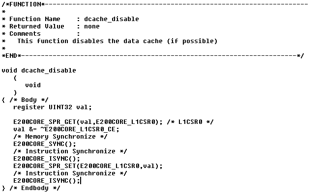

lukaszadrapa
see this file:
c:\Program Files (x86)\Freescale\Standard Software Driver v1.1.0\MPC57xx\Demos\Demo_code\common\DCache.c

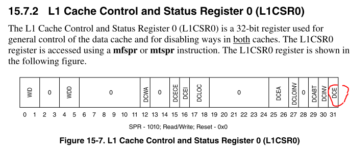

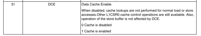

Function "dcache_disable" disables the data cache. It writes L1CSR0 register:
Lukas

lukaszadrapa
No, it doesn't matter if you use SSD drivers or if you write the flash registers by your own code. The result is the same.
For example, let's say that that there are some data in flash, you read them by your SW, so they are cached in data cache memory. If you erase that block now (and it doesn't matter if you do that by SSD drivers or by own code), the cache is not informed about that, so there are still old data. There's no HW coherency unit. You need to either invalidate the cache manually or this area must be set as cache inhibited. Or disable the cache completely but this is usually not an option due to performance.
