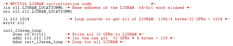

2. When I attempt to initialize the SRAM, the initialization takes several minutes. My routine sets the SRAM beginning address to 0x40000000 and the SRAM size to 0x1FFFF / 0x80. It then loops through SRAM size times, and does the following:
   a. registerVal = sramBegin + (i * 0x80);
   b. writes CPUSCR->WBBRlo with the registerVal, and CPUSCR->IR with the stmw instruction.
   c. Single Steps through the stmw instruction.

2. Because it's necessary to execute 1024 iterations, it makes sense to initialize only small piece of RAM in this way and then load short code to this area which will initialize the rest of RAM. This should be faster option.
Here is an initialization code from CodeWarrior project:
Just compile this piece of code (it needs to be updated as mentioned above because piece of RAM will be initialized via JTAG), load it to RAM, add bkpt instruction at the end and execute in the same way as SSD functions as described in AN3283. bkpt instruction will force the device back to debug mode.
