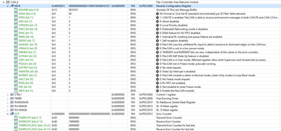

We are using MPC5746C MCU (Part No. - SPC5746CBMMJ6) -1N84S maskset & TJA1145T (FDT0009) CAN Transceiver.
I am trying to send CAN-FD frames from PCAN (PCAN-USB PRO FD) at 500Kbps bitrate to CAN MCU but I am seeing error passive warning or bus-off state at PCAN & also observing error passive state from FLTCONF bit in ESR register of CAN0 along with stuff bit, frame & CRC errors as shown in the below snapshot.
When I try to send classic CAN frame, I am not seeing any errors at PCAN side & able to receive these CAN frames at CAN MCU once individual HW filter is enabled.
I have made sure that FDEN bit in MCR register is set to '1' as shown below:
Please help me in fixing this CAN-FD frames reception issue.

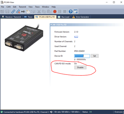

I am able to resolve above issue & receive CAN-FD frames by enabling CAN FD ISO Mode in PCAN as shown below:
As ISO mode is enabled in the CAN driver of CAN MCU, it needs to be enabled at PCAN as well.
