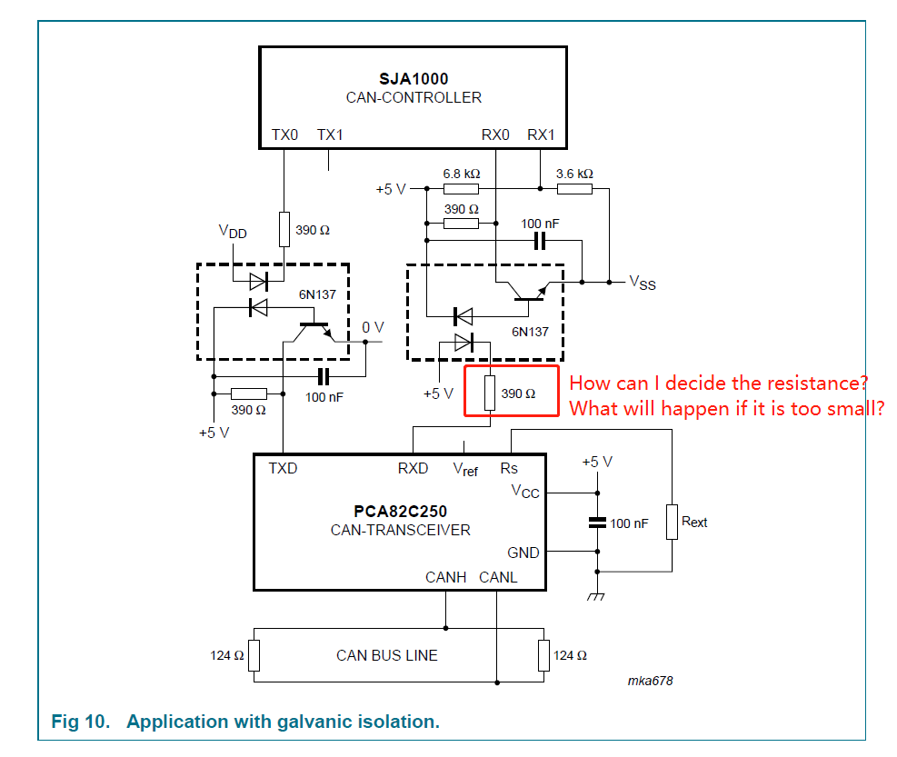

I am doing failure analyse, because the can transeiver PCA82C50 can't communicate normaly.
What will happen, if the input current through TXD/RXD is larger than the max limited current , when I connect a small resistance between 5V supply and pin TXD/RXD. Will it lead to communication failure , or IC damage?(Figure1)

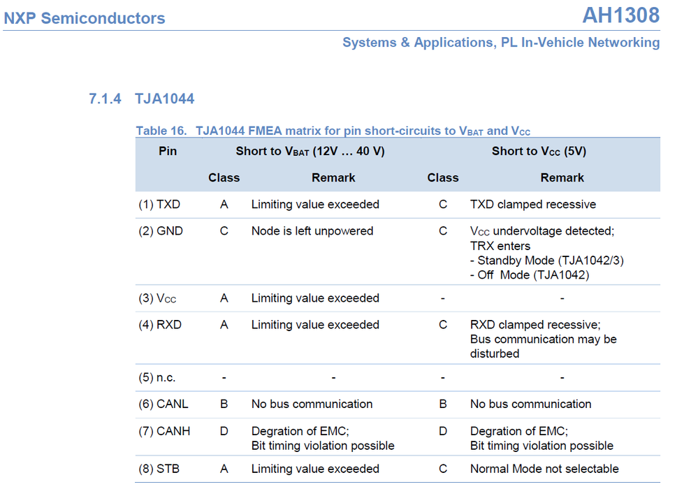

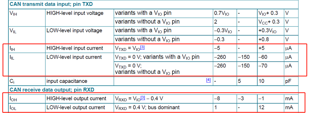

  1. I need to know what limited current(min., max., typ.) of pin RXD , TXD, just like TJA1044 datasheet's decription(Figure2).
  2. It is beterr if there is a pin FMEA description  document about PCA82C50 .(Figure3)

Figure1 Problem Source(from datasheet PCA82C250.pdf)
Figure2 PIN TXD, RXD of TJA1044(from datasheet TJA1044.pdf)
Figure3 TJA1044 PIN FMEA(from application hints AH1308_Application_Hints_Mantis.pdf)
