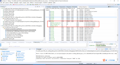

seems clock setting is right. Could this be due to ECC enabled on FlexCAN? If enabled (by default) is all required memory area initialized as mentioned in RM chapter 47.5.13 Detection and Correction of Memory Errors?
*flexcan_mb |= flexcan_mb_config is updating MB CS word, from addresses it should be MB26 on CAN2. It should work, check if module is clocked (in MC_ME module) and enabled (MDIS bit).
BR, Petr
