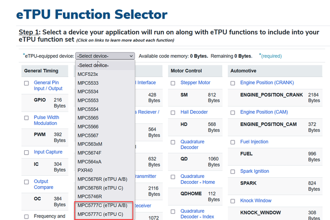

I am not sure if some demo code has been specifically made for MPC5777C device, but you may use any eTPU example, just be sure you have downloaded eTPU function set compiled just for MPC5777C memory setup:
On the eTPU webpages, you may find plenty of appnotes describing particular eTPU funtions, usually containing examples codes:
https://www.nxp.com/design/software/development-software/enhanced-time-processor-unit:eTPU?fsrch=1&s...

eTPU is an complex I/O co-processor. You can use it two ways:
1) with using of eTPU functions prepared by NXP
2) to create your own function or modify NXP’s function
Ad 1)
For using eTPU functions pre-prepared by NXP (the ones you can download by eTPU Function Selector) without modification you don’t need any eTPU compiler. See
http://www.nxp.com/webapp/etpu/
Also there is some new version, currently containing only some functions:
http://www.nxp.com/webapp/etpu_cw/
Only download them, configure by eTPU graphical configuration tool (GCT), include all needed files to CodeWarrior or other compiler and use it.
GCT is the tool which is intended to configure most of functions prepared by NXP that can be downloaded as a pack here:
http://www.nxp.com/webapp/sps/download/license.jsp?colCode=ETPUGCT&Parent_nodeId=1311258915317726989...
Here you can example procedure how to use eTPU PWM function, step by step:
http://www.nxp.com/files/soft_dev_tools/doc/app_note/AN4687.pdf
