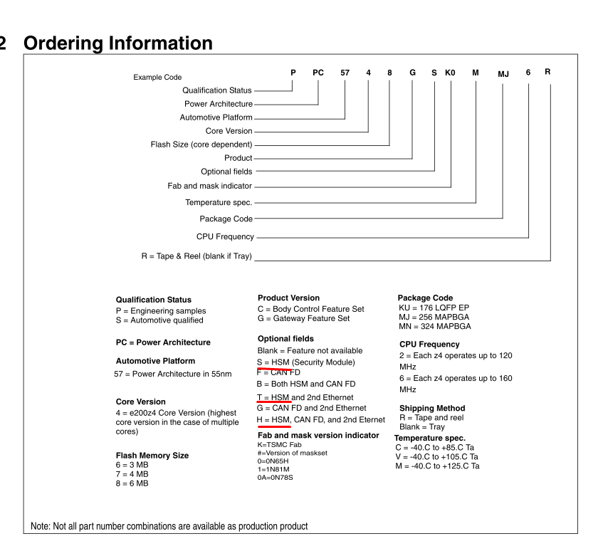

I'm wondering if the DEVKIT-MCP5748G is featured with HSM. If I'm correct, the datasheet says only MCP5748GS is equiped with a HSM.
In case it isn't equiped with HSM, is there an alternative module or feature for data encryption on the MCU?

No Devkit is HSM enabled. In case you want to work with HSM enabled parts, you need to get in touch with your local sales representative. HSM enabled parts come with security firmware programmed.

Not only S version has HSM. Also T and H versions:
I have check the DEVKIT here in lab and it is equiped with S version. So there is HSM available on DEVKIT.
However I cannot see any additional information about HSM availability on our web page.
