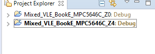

My command line pattern  looks like this: `${COMMAND} ${FLAGS}-mno-vle ${OUTPUT_FLAG} ${OUTPUT_PREFIX}${OUTPUT} ${INPUTS}`
I've attached what my assembly looks like.
I'm really new at all of this so i ask you patience if I don't understand right away.  End goal is to use only non-VLE instructions.

Turns out my devkit likely doesn't support non-VLE instructions.
I'm using the MPC5748G and the most recent version of S32DS.
Here's a link to the reply about VLE on the MPC5748G:  I don'nt know how to enter debugging mode on MPC57... - NXP Community

Sure, you haven't specify the used MCU.
The only MPC57xx devices supporting BookE instruction set is MPC5777C or MPC5775B/E. All others are VLE only.

I have tried this and it works to me.
${COMMAND} ${FLAGS} -c -mno-vle ${OUTPUT_FLAG} ${OUTPUT_PREFIX}${OUTPUT} ${INPUTS}
In the DS, you may see example code:
