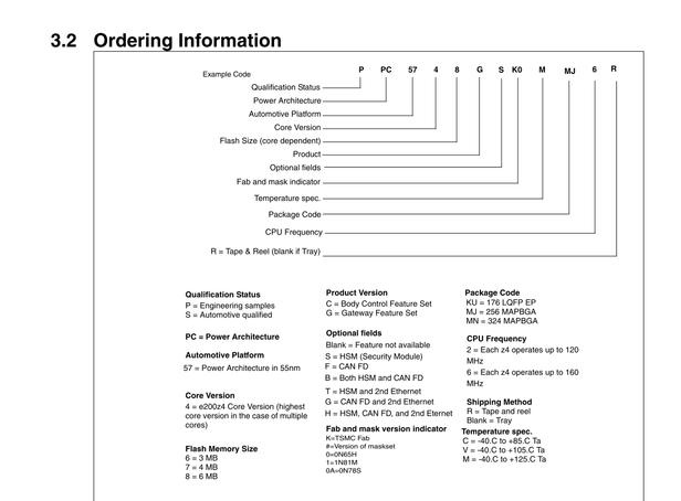

      Can you tell me that there are other differences between SPC5748GHK0AMMJ6 and SPC5748CBK0AMMJ6 apart from the number of cores and USB, do they need to be compatible with hardware design? Are they PintoPin?

This information is in datasheet:
And yes, they are pin to pin compatible.

Is the IO signal Excel in the attachment of SPC5748G RM shared with SPC5748C?
