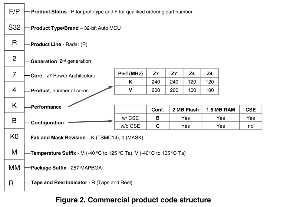

    Can you tell me the difference between  FS32R274KBK2MMM and PS32R274KAK2MMM, thank you !
917 Views
petervlna
This table should bring light into packaging:
It is also included in datasheet.
