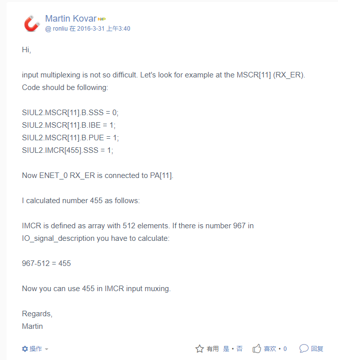

How could I configure the enet_macahb_rx_d0 and rx_er .etc. I can't find the corresponding IMCR register unlike rxdv(IMCR90). The IMCR registers only have 93 in MPC577xK_Muxing_BallMap_Rev2_15.xlsx.
However, in Martin's MPC577xK_ENET_Example:
/* RX_ER */
SIUL2.MSCR[11].B.SSS = 0;
SIUL2.MSCR[11].B.IBE = 1;
SIUL2.MSCR[11].B.PUE = 1;
SIUL2.IMCR[967].B.SSS = 1;
The IMCR number is 967 or as mentioned in
https://community.nxp.com/message/943047?commentID=943047&et=watches.email.thread#comment-943047
the number is 967-512=455
But the question is that I do not have the information about IMCR numbers over 93. Where could I find them?
