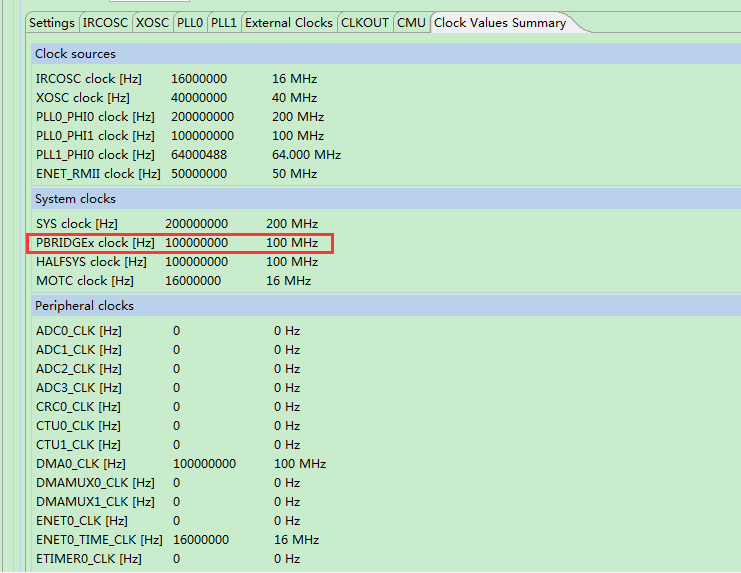

Hello ,  when I use the S32SDK  of  S32_PA RTM 3.0.0.  And the S32DS version is power2.1.
I have some problems.
The PBRIDGEx clock is 100MHz, that is bigger than 50MHz which is support for it !
1,862 Views
petervlna
Yes, you are right.
The PBRIDGE clk is 1/4 of Sysclk.
I will report it to SDK team.
regards,
Peter

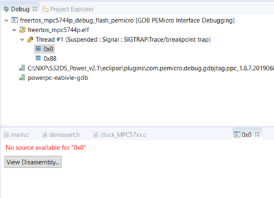

I am also trying to get the FreeRTOS demo working..
I have started from the example.
I have fixed the issue mentioned with the peripheral clock by changing Peripheral clock to 50 Mhz
  • - using component inspector and changing divider to 4.
I have 'Generate processor expert code'
If I run the project in the Open SDA debugger, then it just crashes.
However, if I step through the clock configuration function, CLOCK_SYS_ConfigureMcMe, then the code will run from the next call:
PINS_DRV_Init(...
Then the tasks are working, and the RGB led changes colours.
I have tracked the problem down to MC_ME_ChangeMode(MC_ME);
This function is called twice, and the first one requires stepping through, implying that there is an error in the sequence, or some time must be allowed (for a PLL to settle, or mode to change??).
Finally I removed the first call to MC_ME_ChangeMode(MC_ME); and the code will run from the beginning and the tasks are working.
Can NXP please confirm if the code is correct, and is there a document listing any known bugs with the example codes? Thankyou
