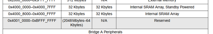

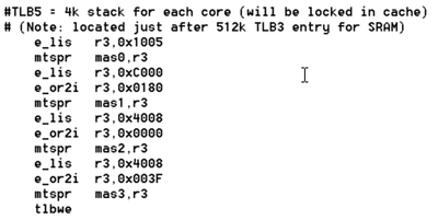

The problem is that in the cookbook, used virtual and physical address is 0x4004_0000 but on MPC5777C there is SRAM space on that address.
Cookbook used MPC55xx and there is nothing in the memory map for that area. That's the point.
You need to choose different address, but how I already answered on address 0x4008_0000, SW startup may configure stack located in cache as we are doing it this way on MPC5777C device.

davidtosenovjan
I see. You can use the rest of cache for increasing SRAM capability for instance as TLB6 or increase the area used for stack to 16k. A procedure described in cookbook in correct in principle.

davidtosenovjan
