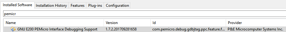

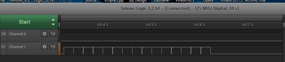

same issue arrrrg! Is that a reset escalation on MPC5748G devkit? (see screenshot + red light is perm ON)
Disappointing if this means silicon heaven! I'm using latest S32DS with with updates, should include the fix that was proposed in https://community.nxp.com/thread/444748?commentID=877631#comment-877631  by lukaszadrapa‌.
Nothing I can do about it? Could you ship me a new one..............please?

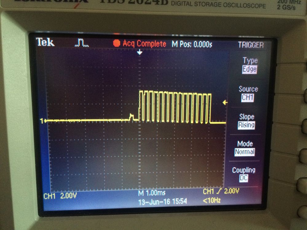

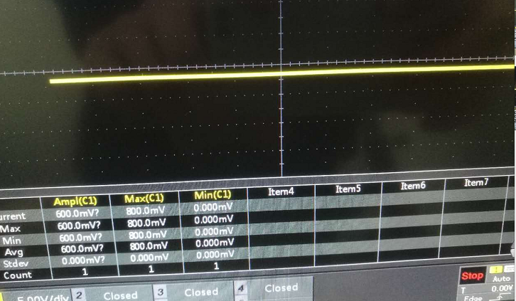

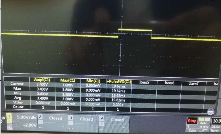

Hi Martin,
and another board reset signal is as follows
4,209 Views
martin_kovar
I am not sure about the first figure. Is this reset line of working microcontroller? What time base have you set? How long is the pulse?
About second figure, if this is signal triggered after power on reset, your microcontroller is "dead".
Martin

martin_kovar
after power on reset, what signal do you see on reset line?
Is there reset escalation?
Or you see reset line still in logic 0?
If reset line is still in logic 0 (you do not see reset escalation), could you please read thread below and let me know, if it could be applicable to your issue?
https://community.nxp.com/message/877631?commentID=877631#comment-877631
