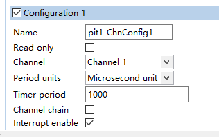

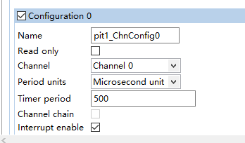

I want to enable multiple interrupts。
In the pit module I found the Channel configurations list and make the following settings
_0-1630981012264.png_1-1630981028568.png_2-1630981040803.png_3-1630981053986.png_4-1630981065953.png
But my call in the man.c function fails。Only pit1_ChnConfig0 is working well, how should I enable the other channels?
Online etc.!!!!!!
709 Views
PetrS
did you call all necessary functions to init PIT, channels, install handler and start channels?
See driver documentation C:/NXP/S32DS_Power_v2.1/S32DS/software/S32_SDK_S32PA_RTM_3.0.3/doc/html_MPC5777C/group__pit__drv.html
BR, Petr
