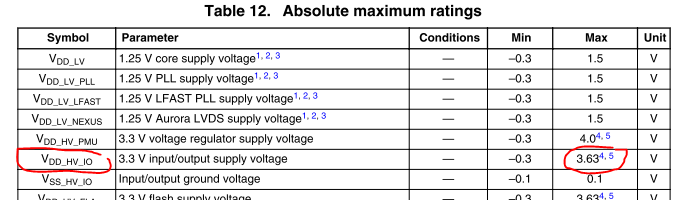

Can the VDD_HV_IO and VDD_HV_ADRE of the MPC5744P be powered from a 5V supply?
418 Views
lukaszadrapa
VDD_HV_IO can be supplied by 3.3V only:
VDD_HV_ADRE can be either 3.3V or 5V:
And notice that:
Lukas

my_souls
Thank you very much!
