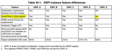

hi there,
as you can see from the picture, DSPI_E module does not support a few features. In my project I need to use all of the DSPI modules as SPI. Highlighted part of image says there is no SIN ability on DSPI_E. Can I use DSPI_E as normal SPI communication? Limitations affect me?

Hi Furkan,
see please solution in this thread:
https://community.nxp.com/t5/MPC5xxx/MPC5777C-DSPI-E-without-SIN/td-p/1220958
