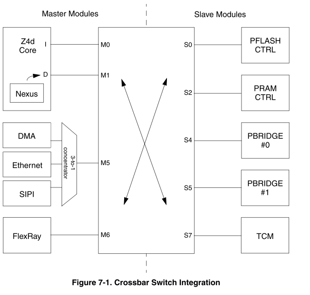

hi,
i have a new question about DMA function. today when i debug my program ,i found that when i doing EEPROM write operation on the frequency of very fast, my DMA will delay max to 3us. i can not explain this strange phenomenon to my colleague. so i want to know, can Flash Write operation effect DMA and how effect the DMA?
PS: i used the EEE_Driver_v1.2.0 to realize the EEPROM function by using flash.

The default priorities are: (where 0 is highest)
M0 -> 0
M1 -> 1
M5 -> 2
M6 -> 3
So if your core is accessing slave and in the same time DMA want to access it it must wait until higher priority master release accessed slave. There is no time limit.

petervlna
Yes, it can.
Unfortunately you didn't specified the device you are using. So its hard to tell the root cause.
Have in mind that there is a XBAR which arbitrate accesses for masters to slaves.
Foe example if you are accessing to flash via core, and in same time DMA want to access flash. Master with lower XBAR priority must wait until slave is released from master of higher priority.
Peter

liujinhang
another important information is that i did not configure the XBAR, so the xbar function runs on its default configuration.

liujinhang
Hi Peter,
thank you very much! i did the test by setting the DMA highest priority to access all slave ports. and the problem
disappears.
