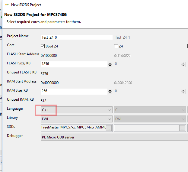

In S32 DS we created a project for the mpc5748g and selected C++ as the programming language.

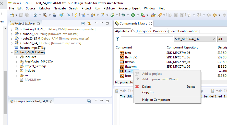

The project generates and compiles.  But it is not possible to add components from the Component Explorer:
What needs to be done to use Components in a C++ project?

Hello Michael,
C++ project can be used in MPC5748G. I am only trying to explain that SDK drivers has never been tested in C++ projects.
So, you can write your own driver which is based on SDK driver using C++, but functionality of SDK driver is not guaranteed. From my point of view, it will work correct, but this is only my opinion.

martin_kovar
unfortunately, this is not possible. SDK is determined for C projects only and cannot be used for C++ projects.

martin_kovar
in general, SDK code has never been tested in C++ projects and it is not determined to use in C++ project. I understand that C code can be called in C++ projects, but NXP cannot guarantee correct functionality.
So, you can try to use SDK drivers in your C++ project, but it is on your responsibility.
