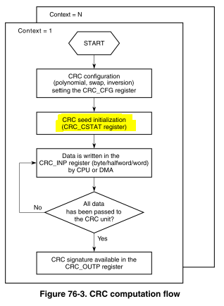

I am developing on MPC5746C.
I referred a sample code in below answer and the CRC calculation itself works but I have no idea why the CRC value is different after flash write.
The problem is CRC#2 and CRC#8 is different even if the data is same.
I think the only difference is CSTAT(CRC Current Status) value when I had a look at peripheral register in trace32.
But, still I have no idea why it is different.
The init_edma function is passed through but should I initialize something more?

boyeonkim
I initialized all related registers as same as your sample code.
Another problem was I put a wrong source address value (pointer's address) on SADDR register.
Then, it works!!
Please make sure your source address value is right with Trace32 if anyone has same problem with me.
Thank you very much, Lukas!

lukaszadrapa
Hi Katie,
it is important to set the seed value in CRC_CSTAT before calculating CRC. If the seed value is different when calculating CRC of the same structure, the result will be also different.
