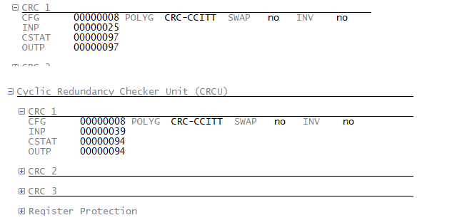

So the MPC5643L cut2/3 supports CRC8, 16 and 32 polynomial. Using the CRC_CFG register I'm able to select between CRC16 and CRC32 and somehow I can't configure CRC8. Does anyone else faced this problem ?

an updated version of the MPC5643L peripheral view file is available. You can download it here:
https://www.lauterbach.com/scripts/per/cd_/permpc564xl.per
Copy it into your TRACE32 installation folder.
Reinhard

petervlna
It is working properly. Only Lauterbach is not showing it in peripheral script.
