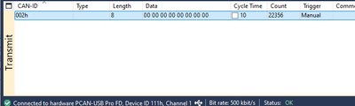

this is a result I got with SDK303 flexcan demo example. I used configuration from example
and have PCAN USB Pro connected with below setting
I see no issue in communication and this is measurement done on CAN_L, TXD and RXD pins
1. message sent upon SW button press
2. message received from PCAN
3. message sent upon SW button press, bus disconnected, but board terminated. Message transmitted still as there is no ACK
4. message sent upon SW button press, bus disconnected, but board not terminated. Message cannot be transmitted at all, bit error detected, error frames sent
So I got very expected results.
BR, Petr

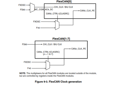

CAN PE clock is derived either from FXOSC or F40 depending CTRL1[CLKSRC] bit setting
If you select FXOSC as system clock then F40 will be less that CAN PE clock which is not possible. You need to have config where CHI_CLK/BIU_CLK is not smaller the CAN PE clock
So be sure your CAN PE clock is properly set and you know its freq, so CAN bit timing can be calculated and set. If you are using below

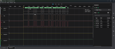

thanks again for replying. I analyzed the CAN Frames back then with a Logic Analyzer 8 from Saleae and did it again. The part I can't explain is that the MCU only sends valid CAN frames when using this specific configuration:
flexcan_time_segment_t ts = {
.propSeg = 6u,
.phaseSeg1 = 7u,
.phaseSeg2 = 2u,
.preDivider = 9u,
.rJumpwidth = 2u
When I flash other configuration, like the 500kbit/s config I showed in my last message, it doesn't transmit any meaningful frame at all.
I've attached two Saleae captures along with my minimal main.c, which simply sends CAN frames periodically.
I truly appreciate your support!
BR, Alex

I work with the DEVKIT-MPC5748G and use the integrated CAN Transceiver (A104463). The measurement was done with a connection to the Vector VN5650 via CAN. The Vector was measuring aswell. As you can see at the png LogicAnalyzer, he sent ACK.
I measured now at CAN with the board disconnected from the bus and the output is the same as shown in the png's, of course with exception of the ACK.
I measured now aswell the TXD pin with the working bit config. It shows the same frame, but the first bitrash is 1.5-2 µs longer than the same bitrash measured at CAN.
The 500kbit/s config shows at the txd pin no senseful frame either. But here are also the frames about 1.5 - 2 µs longer.
About the termination topic: There is a jumper at the board. If I stick it in, I can see absolutely nothing. Only works, when I don't plug it in.
