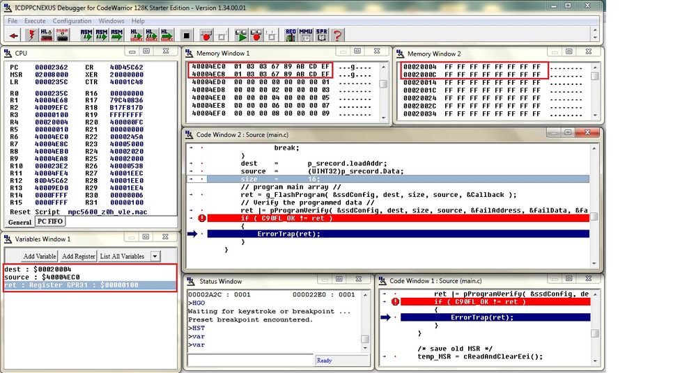

Hello all,
I'm using MPC5602P on CW2.9. I'm trying to implement Flash Boot Loader using SSD drivers. Initially I tested without FBL with random values, everything worked well. I added my FBL code and
     dest = p_srecord.loadAddr;
     source = (UINT32)p_srecord.Data;
     size = 16;
     // program main array //
        ret = g_FlashProgram( &ssdConfig, dest, size, source, &Callback );
        // Verify the programmed data //
        ret |= pProgramVerify( &ssdConfig, dest, size, source, &failAddress, &failData, &failSource, &Callback);
        if ( C90FL_OK != ret )
            ErrorTrap(ret);
Later after executing the FlashProgram function I'm getting C90FL_ERROR_ALIGNMENT. I'm attaching the image here.
From the image, we can verify the dest address is correct and the data showing in memory window 1 is also perfect. But it is giving the return value 0x00000100 (C90FL_ERROR_ALIGNMENT).

I got it,
The C90FL_ERROR_ALIGNMENT will occur if the destination address we transmit satisfies the following condition,
 if ( ((dest | size) % C90FL_DWORD_SIZE) != 0 )
returnCode = C90FL_ERROR_ALIGNMENT;
