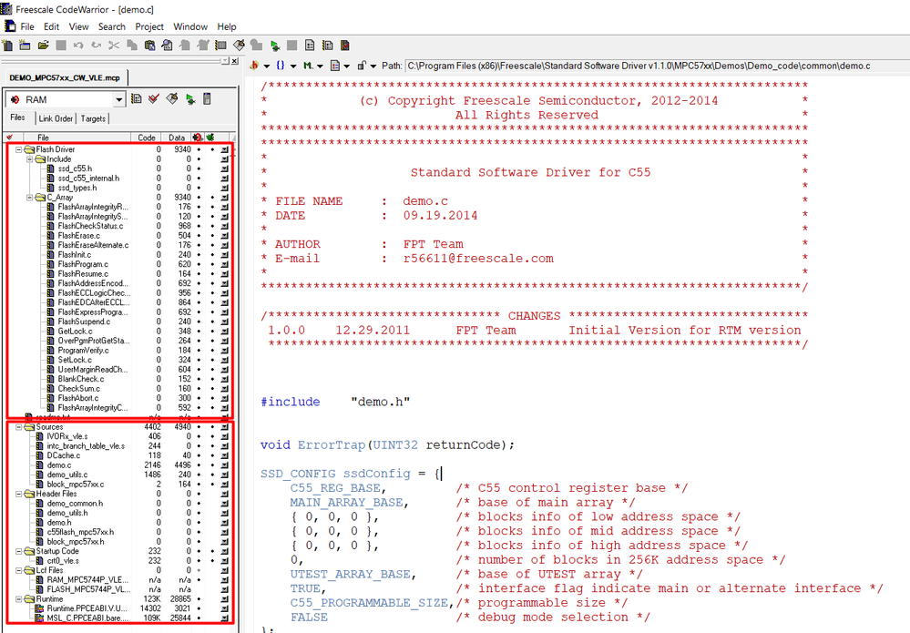

   I have download the C55 Flash module Driver  On NXP Web ,but I don't now how to use that .
   First I read the SSD_C55_UM_v1.1 which is explain the function ,and I have see a lot of files (.c,.h)
   but I haven't  see The way the function is implemented,could you tell me how to use the C55 Flash Driver.
   Second I don't konw the C55 Flash Driver if is's OK to use on S32DS . Thank you .

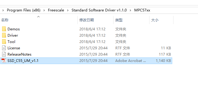

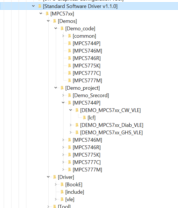

There are prepared example codes for 3 compilers (GHS, DIAB and CodeWarrior). S32 Design studio has been issued later than C55 Standard Software Driver, example for this is not included. However it should not be difficult to run it with S32DS as the driver itself is based on C files (.c and .h) as well as most files of demo code.
The particular example code's files are spread between 3 folders (Demo_project, Demo_code and Driver).
I made screenshots for you (below) to understand which files it is needed to include to you S32DS base project.
Hope it helps a bit

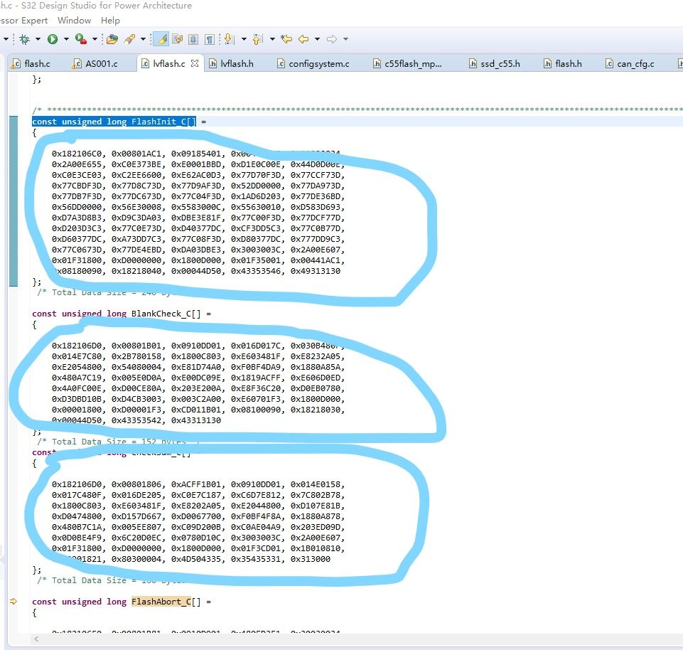

                 I almost know how to use the driver,but I still have one question ,What these arrays represent like that
                 const unsigned long BlankCheck_C[],const unsigned long FlashInit_C[].
                 Are there any address in the arrays or any other things .If you know please tell me .thank you .

It is just the driver itself. These C-arrays are pre-compiled routines because of
1) to make them compiler independent
2) to be easily operated without possibility of mistake or failure
These C-arrays are executed as a code.
