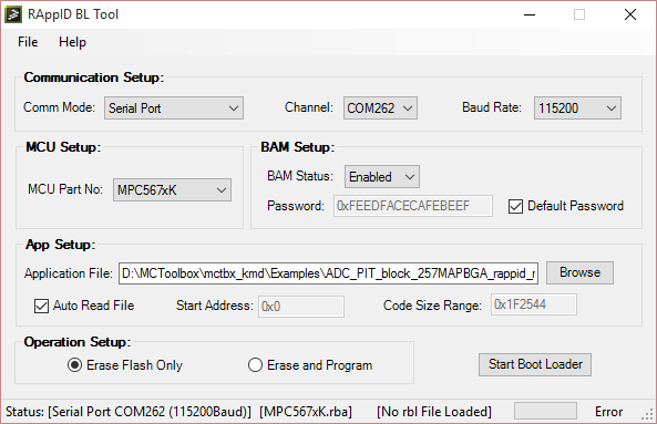

jcsansao
Dear Cenk and Lukas,
I really need some help here...
I´m trying, without success, to use the Rappid Bootloader for a while, but I get always the same answer, loss of communication.
I´m using the MPC5675K 257 pins eval board and a usb-to-serial cable connected to the SCI port, and until now, I try the following:
- ensure the RCHW bit is set to VLE;
- ensure board is in DPM
Do you know any other option I could explore?
My configuration is as follows:
Thanks a lot
5,234 Views
lukaszadrapa
I tried the Rappid Booltoader on my board and I can't make it working too. I can see that the MPC567xK.rba is successfully loaded to RAM (confirmed by debugger) and the code is executed but the tool running on PC says that communication was lost. I will ask Rappid team if they can provide some hints...
