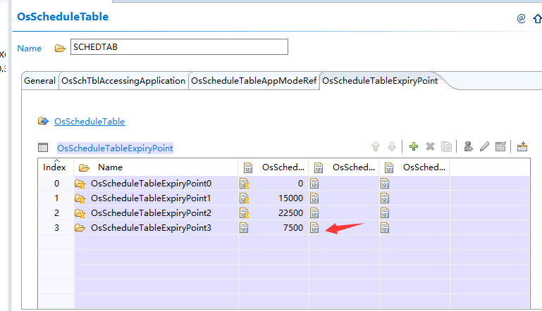

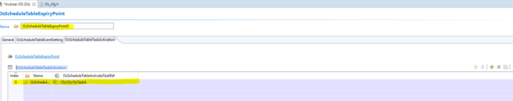

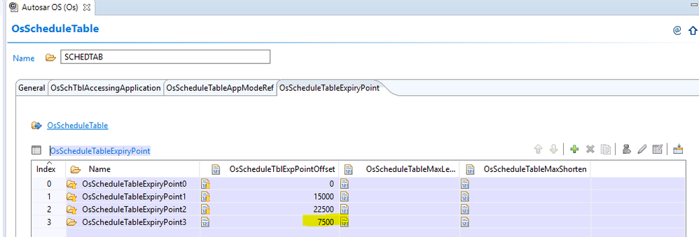

I see in your project:
- OsScheduleTableExpiryPoint3 is setup every 7500 ticks based on the counter of the Schedule Table:
- TaskCnt is setup in this expired point, so it should be called every 7500 ticks

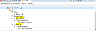

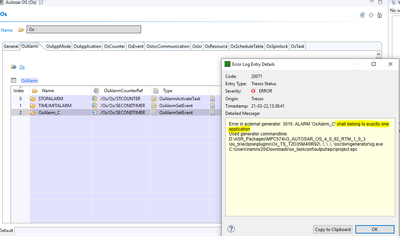

- The OsAlarm_C is setting up incorrectly:
It's because Os_AlarmC is assigned to both TRUSTED_APP and TASK_APP, and only one application should be chosen:

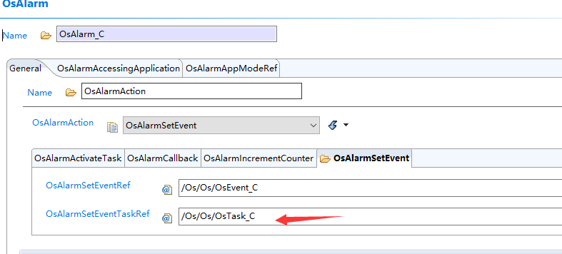

Add task C to the project to activate the alarm, as shown in the figure.
The way you want to achieve this is to extend the activation event waiting for task C to trigger.

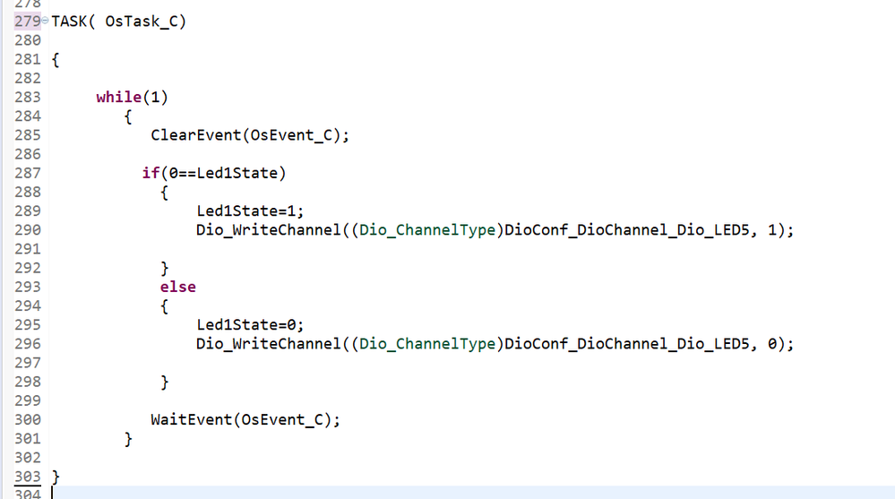

lubo_NEW
My final goal is to create an extended task C with the code "Status = WaitEvent(osEvent_c)" in the task;
Wait for an event to occur to activate task C. Simulation will find that it can enter task C at startup,
and then it will hang forever.I don't enter task C anymore,
and then I find that the previous code was incorrectly written as "Status = WaitEvent(OSTASK_C)", so the task hangs forever
Then you said that an extended task requires a schedule table or an event to be activated.
I understand event activation, but I don't understand schedule activation
8,068 Views

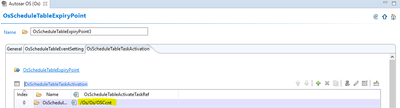

namnguyenviet
Task activation by schedule table is like how you do with the TaskCnt. Is there any problem with TaskCnt function call?
8,057 Views
lubo_NEW
Thank you very much for your patient reply.
In general, can a scheduled table activate an extended task like a taskCNT task
8,048 Views
namnguyenviet
The difference between basic task and extended task is the wait state is available on in extended task. Otherwise, there would be no difference and theoretically, extended task can be scheduled in schedule table as basic task.
8,031 Views

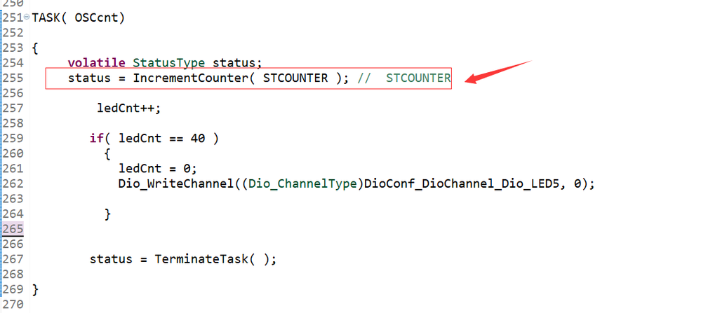

The TaskCnt function scheduler would have a ExpiryPoint that would be a context call for a basic task?
Status = incrementCounter (stCounter);
Task (TaskCNT)status = incrementCounter (stCounter) statement conflict in the official SAMLPE?QQ图片20210323112507.png
8,060 Views
namnguyenviet
In the example, TASKCnt is not used in waiting for event context, so it should be basic task.

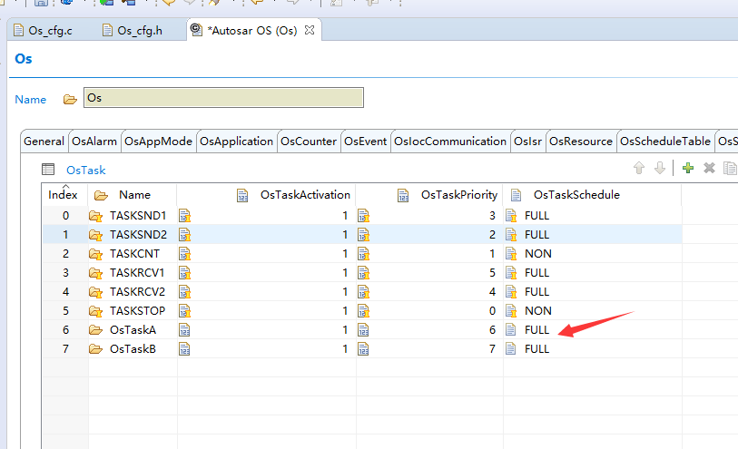

lubo_NEW
The code in the project looks like this, task A does reverse task B does nothing, rightQQ图片20210316212530.png
The attachment is my EB configuration OS project. Could you please help me to see the reason? Thank you
8,264 Views
namnguyenviet
Has your added task (OsTaskA, OsTaskB) are executed during runtime? Could you provide the SW call stack before entering Os_Shutdown?
