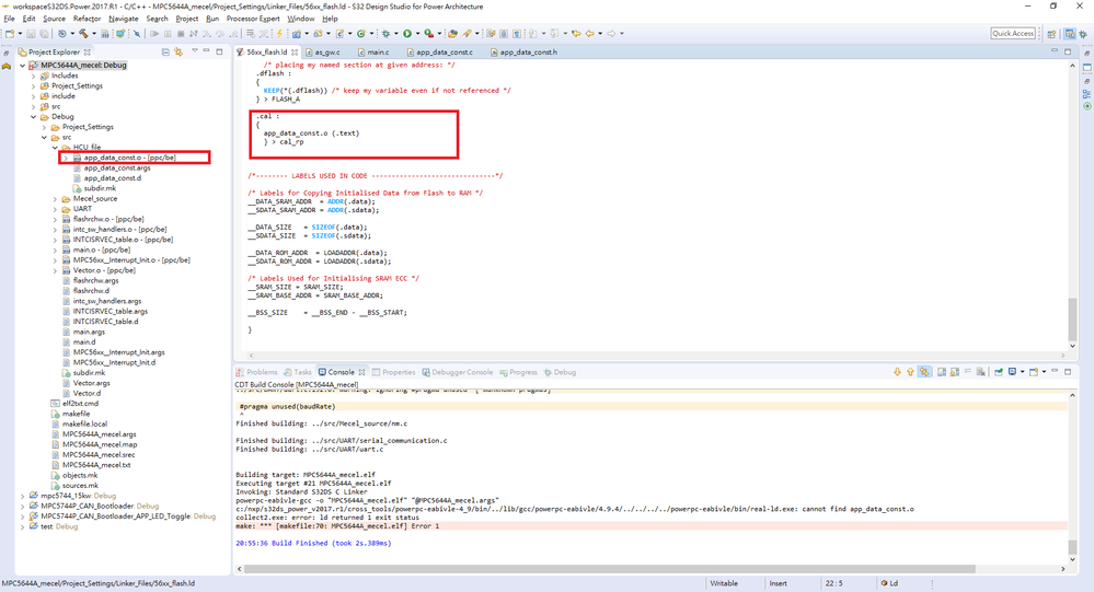

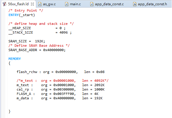

Hi everyone
i have a problem of MPC5644A load specified file to the rom section.
Could someone tell me how to do this?
