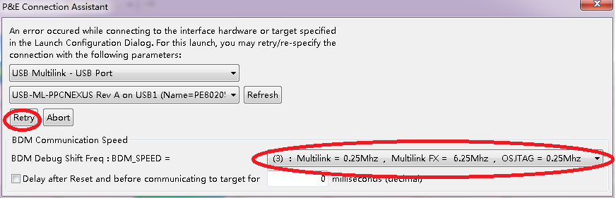

Dear all:
         I was using USB multilink debug my board, the following error:
And I will be transferred here parameters: (3): Multilink = 0.25Mhz, Multilink = 6.25Mhz, OSJTAG=0.25Mhz, press Retry to debug, I would like to ask why is this?
In addition, in a development board, set to " (0): Multilink = 1Mhz, Multilink = 25Mhz, OSJTAG=0.25Mhz" can be debugged. Is not my board debugging interface circuit problems?
Look forward to your reply

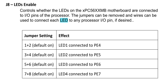

I tested your code and it works correct for me. From my understanding you would like to blink LED diode. In main function you toggle pin PC13, but this pin is not connected to any LED diode on MPC56xx EVB motherboard.
LED diodes are connected to the following pins:
So if you want to use PC13, you have to connect this pin to LED diode manually.
Please let me know, if I understood your issue correct.

skysword
       In this way, the MPC56xx EVB motherboard can be set by PE4, PE5, PE6, and PE7 pins to allow the corresponding LED light to be low.

martin_kovar
could you please check, if FAB pin is in logical 0 during reset? Also you can look at SSCM register and check if BMODE is 011 (Single chip mode).
Martin
7,770 Views
skysword
I checked the FAB is high, and then I dropped to the external low, and then download the program to the flash can run.
This problem has been bothering me for a few days, and now it's settled. Thank you for your technical support.

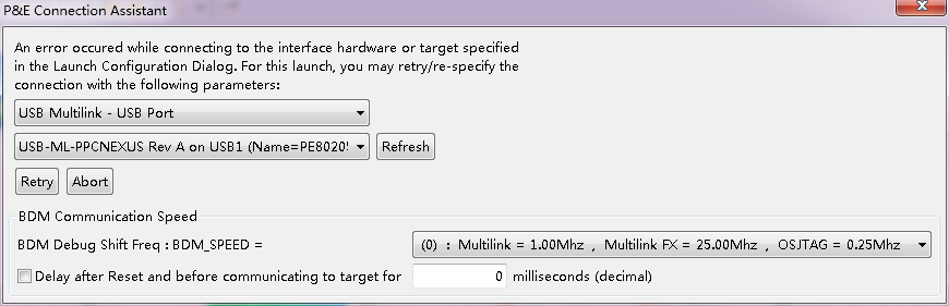

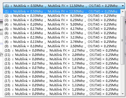

But why the BDM_SPEED is set to " (3): Multilink = 0.25Mhz, Multilink = 6.25Mhz, OSJTAG=0.25Mhz" and the following can be downloaded for debugging,
BDM_SPEED is set to
" (0): Multilink = 1Mhz, Multilink = 25Mhz, OSJTAG=0.25Mhz" or
" (1): Multilink = 0.5Mhz, Multilink = 12.5Mhz, OSJTAG=0.25Mhz" or
(2): Multilink = 0.33Mhz, Multilink = 8.33Mhz, OSJTAG=0.25Mhz" but can not download debugging.
In the MPC56xx EVB motherboard of any value of the BDM_SPEED can be downloaded debugging,
Is SPC5606SF2VLU6R not supporting too fast?Or what are the factors that affect the speed of the BDM_SPEED?

martin_kovar
the speed is mostly dependent on wires impedance. Also robustness of the design can affect the speed you are able to communicate with device.

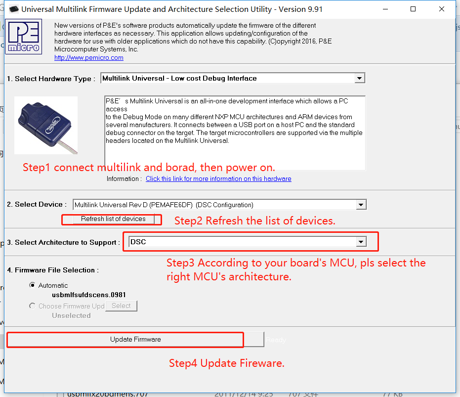

fortunely
Maybe my experience will help you. It is useful to ensure the fireware is OK.
One debugger multilink universal can not work on evb WCT-15WTXAUTO(Interface: 14PIN JTAG), which the same error message occurs to you, but another debugger can work normally. I can no hardware, even though the all the multilink can work on evb FRDM-KEA128Q80(Interface: mini 10).
That is,
EVBMCUSeriesINTERFACEMULTILINK AMULTILINK B
 FRDM-KEA128Q80KEAZ128Cortex-M0+
PORT G
MINI 10
OKOK
WCT-15WTXAUTOWCT1013DSC
PORTA
14PIN JTAG
THE SAME ERROROK
You can try to update the fireware of U-Multilink by PEFirmwareUpdater.exe. My install root directory is C:\PEMicro\multilink_universal\PEFirmwareUpdater.exe.
