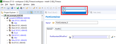

If my understanding is correct, you're requesting using multi variant config in EB Tresos.
Please refer this thread to setup variants for Port module in your config:
Solved: MCAL Variant Handling in EB Tresos - NXP Community
After configured, you will see on the top of each module, the variant parameter can be selectable:cuongnguyenphu_1-1662522194603.pngcuongnguyenphu_1-1662522194603.png
Select each variant and config Port module as per variant.
Then after generated, you will get different config set generated in separate file:
Using these config corresponding with for projects

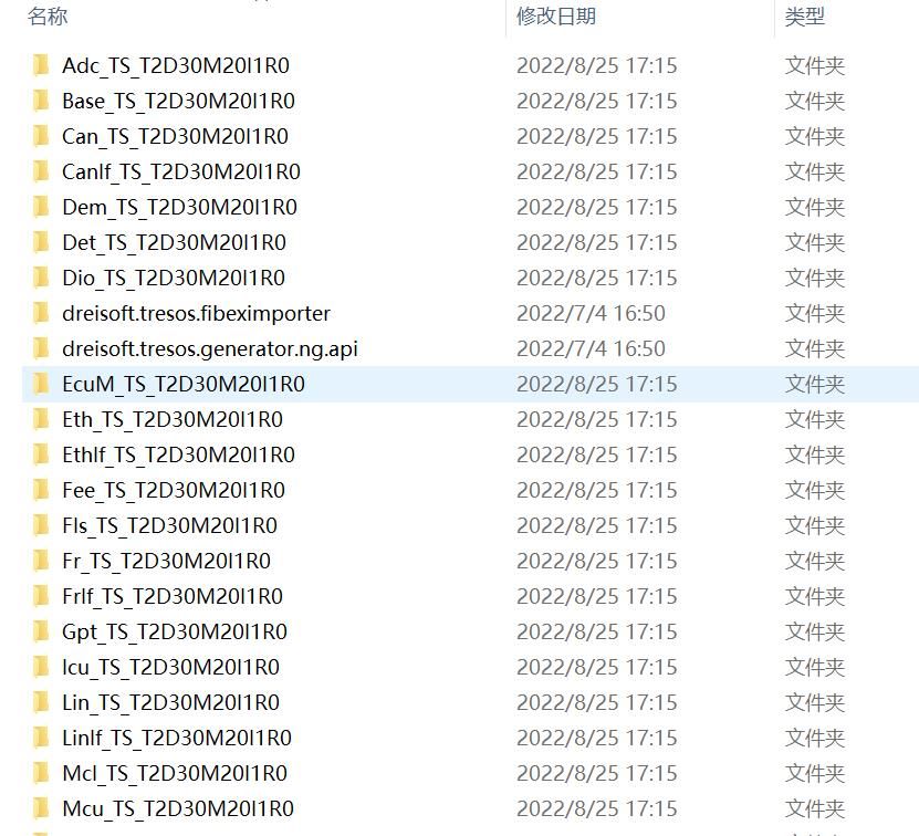

Thank you for your reply@cuongnguyenphu,I refer this thread to setup variants for Port module in my config: Solved: MCAL Variant Handling in EB Tresos - NXP Community
but I found there is no EcuC module in the MCAL pulgins installation path of MPC5744P, so the pulgins file of EB tresos installation path also have no EcuC module. And finally, I can't using multi variant config in EB Tresos.

Which version MCAL for MPC5744 that you're using ?
4,235件の閲覧回数
ShuxinHuang
This Version
4,224件の閲覧回数
cuongnguyenphu
This package for MPC57xP series didn't support for multi variant.
