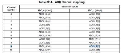

Why, in the example, is number 9 assigned as the ADC_Channel_Number when PB[4] corresponds to precision channel 0 in the ADC1?
 #define ADC_CHAN_NUM (9u) /* ADC1_P[0] corresponding to PB[4] */
2,607 Views
PetrS
see Table 32-4. ADC channel mapping of the RM.
ADC1_P[0] is mapped to the channel 9 of the ADC1
