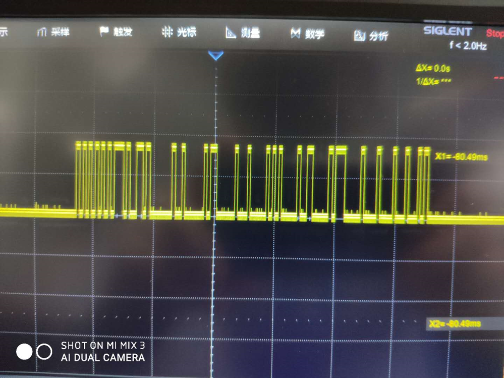

I test the LIN driver on SPC5748G (BGA257),Data can be sent out。But the default level is indeed low,This is obviously wrong for the LIN bus protocol。I tried adding a 1.5K pull-up resistor to the TX pin to pull it up to a high level,it's OK,Is there something wrong with my configuration?

When LINFlex is in idle state the TX pins are set to high-impedance. If LIN transceiver does not have internal pull-up an
external pull-up may be required.
