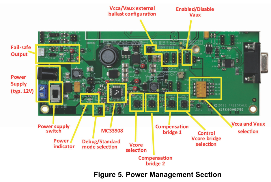

      Did you have solved your problem? I also use GHS MULTI IDE  and EVB is KIT33908MBEVBE+KITMPC5744DBEVM .Now, the CAN0 ( FlexCAN module) can not work well,too.  Is it must  that the SBC chip be initialized and CAN transceiver enabled by codes?Because as we know,when JP112 is set,the CAN transceiver  is in normal mode.Look forward to your reply!

Hi Petr,
I modify MPC5744P-MPC33908 demo code in test2 project, and I confirm the CAN transceiver is in normal mode.
I set KIT33908MBEVBE in debug mode(set jp112), but CAN date frame does not be send. Could you help me check, please?

PetrS
this example was written for and tested on the MPC5744P EVB and it works well on this EVB.
With your demo board this example cannot work as the SBC CAN transceiver is used on the motherboard (KIT33908MBEVBE). The SBC chip must be initialized and CAN transceiver enabled.
You can refer to the demo code for this board; https://www.nxp.com/webapp/Download?colCode=MPC5744P-MC33907-MC33908-DEMO. It does the SCB init as well as simple CAN transmit.
