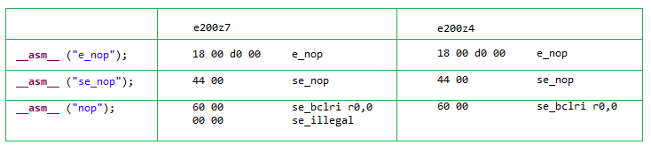

   When you compile these code within IDE, you can get the results as below.
The code could run correctly except __asm__ ("nop").  Some MPC5xxx will stop at __asm__ ("nop").
"nop"         gives Book E NOP instruction which isn't valid on VLE only cores.
"e_nop"     gives 32bit VLE instruction.
"se_nop"   gives 16bit VLE instruction.
Based on the summary within AN4802 (thanks for Randy Dee's working), Qorivva MPC57xx e200zx Core Differences, Book E is not supported by MPC57xx. VLE instruction set is supported only.
This is the reason that user should use "e_nop" or "se_nop" except "nop" on MPC57xx or S32R2xx.
