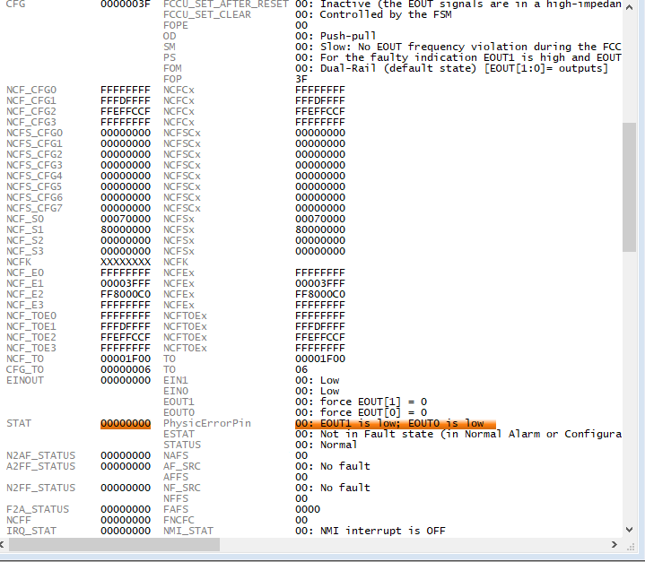

I am working on S32R274 and I need help for SWT_2.
I need your help regarding above code :
I am not able to see the NCFS_CFG0 is getting updated with my value 0x40000000 .
FCCU.NCFS_CFG[0].R = 0x40000000;.
and I can see that, NCF_S0  is showing value 0x00070000.
Below are the screen shot during debug :
Could please help me,. why this value NCF_S0 = 0x00070000, as I have just configure SWT_2 only.
and why I am not able to see the my written value in NCFS_CFG0.
Thanks !
Hmm, and do you performing FCCU configuration in FCCU CONFIG mode?

If timeout expires the SWT causes a reset, after this reset next timeout the SWT no longer reset.
I try the interrupt mode and the IR is correctly triggered in both cases but no reset after first reset.
What could be the problem?
What can I check?
Thank in advance.
Salvatore.

Since you did not share much about your test setup, I guess it can be debugger whose preventing the code run or simply disable SWT as most debuggers do automatically.

Sorry, I've solved the problem. I had commented FCCU_clear_faults(). Now work.
